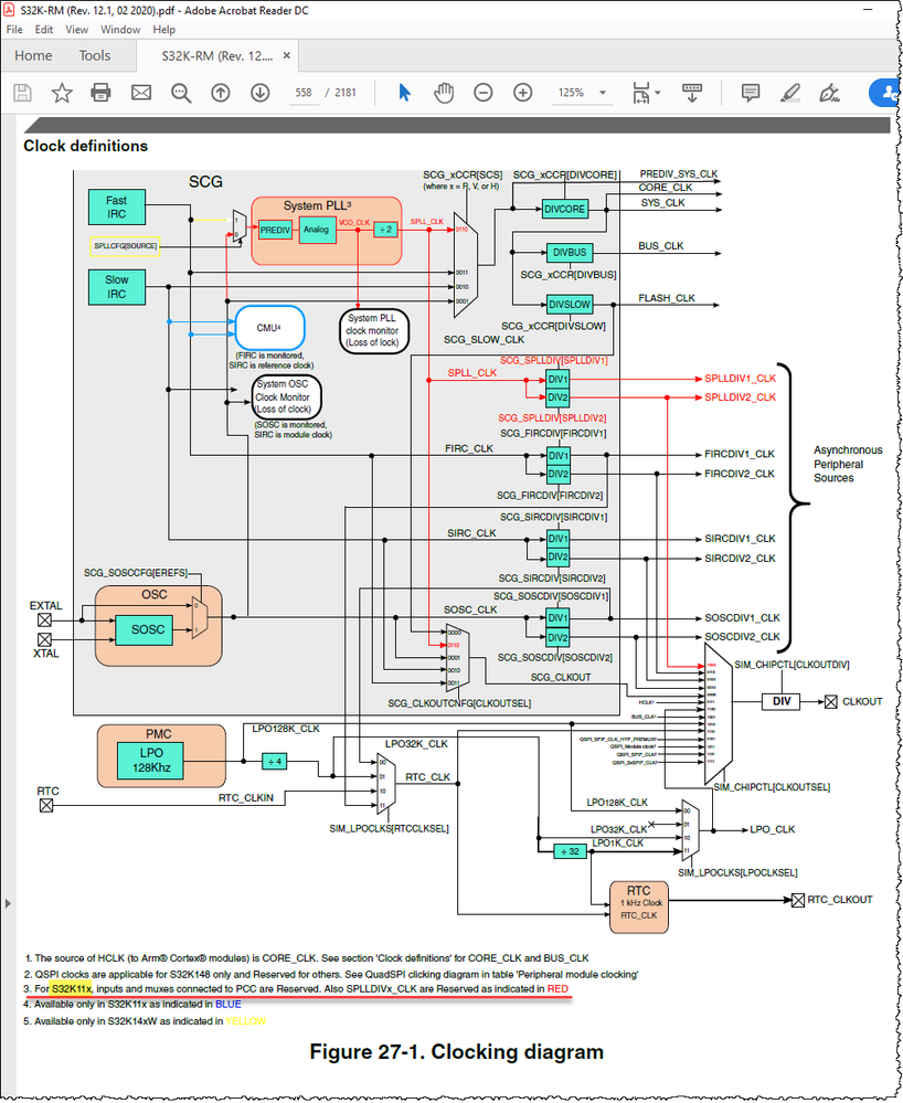

Hi jinsheng20,
The Phase-locked loop (PLL) is not available for the S32K11x product series. That is why you cannot configure it.
Robin

1090097669
Hi Robin,
according to Datasheert,the  and the current consumption it is 21mA,and following Code which the current consumption it is 4mA,it should be less than 1mA.
how to further reduce the current consumption by the controller?
 And also how to disable the clock monitors?
And if possible also let me know how to come to normal RUN mode through CAN
Please point out my configuration errors or missing areas
