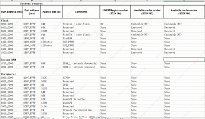

How can I set :HEAP_SIZE ; STACK_SIZE ;M_VECTOR_RAM_SIZE
2,088件の閲覧回数
jingfang
How can I set :HEAP_SIZE ; STACK_SIZE ;M_VECTOR_RAM_SIZE?
How about range?
2,065件の閲覧回数
VaneB
Hi @jingfang
To be in the same context I am going to take as a reference the attached which is a structure of a linker file from an SDK example.
The size of the bss, stack and heap are taken concerning memory space in m_data_2(SRAM_U). So sizes are theoretically limited by available SRAM memory.
Regarding, the vector ram size is taken concerning memory space in m_data(SRAM_L), but unlike the previous one, in this one, there is also data ram and code ram.
You also could try to use the m_data section for heap and stack, but you would need to corroborate that you have still memory space in this section.

3 返答(返信)
2,080件の閲覧回数
VaneB
Hi @jingfang
Witch MCU are you using?
Let me suggest to you take a look at the linker files of the example projects for S32K1 and S32K3, there you are going to be able to find how these are set.
Also, the range depends on the memory.
B.R.
VaneB
2,072件の閲覧回数
jingfang
S32K144,how should be respond?
2,066件の閲覧回数
VaneB
Hi @jingfang
