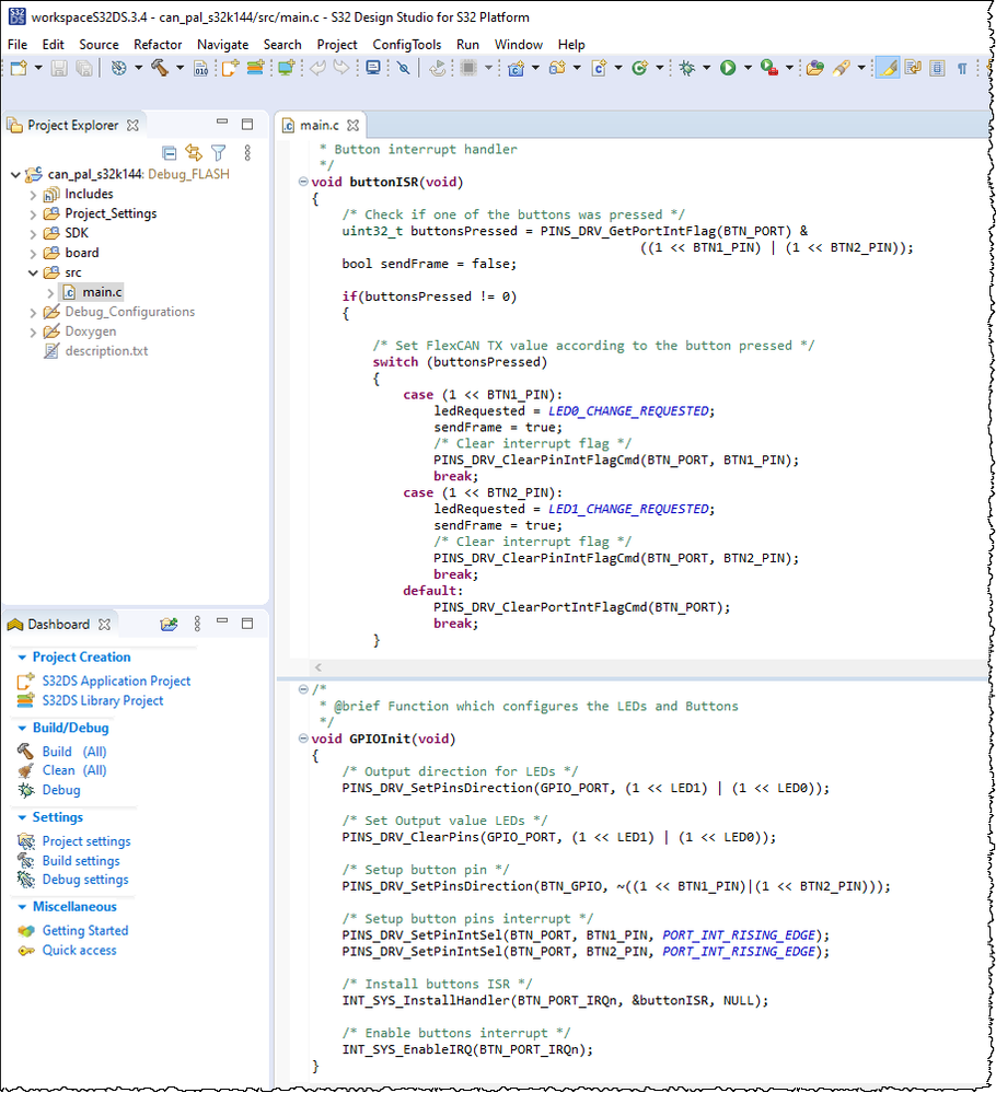

Robin_Shen
Sorry we don't have example project with membrane keypad.
But I think you can use PORT interrupt to check which pin has be pressed.
You can refer the Button interrupt in can_pal_s32k144 of SDK.
