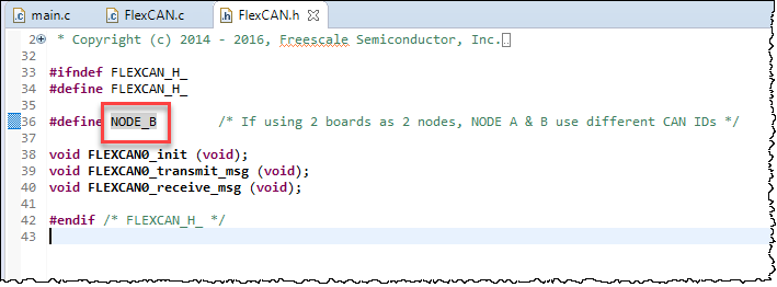

If you want to only receive CAN Message with the ID 0X555, you can direct #define NODE_B in FlexCAN.h.(The codes has configure check all ID bits and allow 0x555 by default.)
Once you receive the CAN Message with the ID 0X555, the ricevuto will be true.

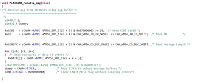

If you want to use print on the console the ID of CAN message, please refer the "S32K144_Project_LPUART".
The ID of CAN message(RxID) will be read in FLEXCAN0_receive_msg.

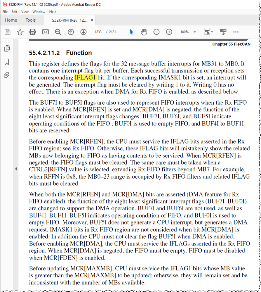

I have a question: the condition CAN0->IFLAG1 >> 4) & 1 is true when the reception of CAN message is finished or it is true at the start of reception?
I need a condition that is true at the start of the reception because then, I must acquire thank the ADC the physical value of CAN-High e CAN-Low.

The condition CAN0->IFLAG1 >> 4) & 1 is true each successful transmission or reception. The FLEXCAN0_receive_msg will Clear CAN 0 MB 4 flag(make the CAN0->IFLAG1 >> 4) & 1 is false).
I am afraid the IFLAG1 does not meet your needs, because the reception has finished.
FLEXCAN0_receive_msg.pngFLEXCAN0_receive_msg.png55.4.2.11 Interrupt Flags 1 register (IFLAG1).png55.4.2.11 Interrupt Flags 1 register (IFLAG1).png

Robin could I ask you some things about CAN that I didn't understand? In the function FlexCAN_receive_msg I don't understand how the variable RXCODE, RXID are stored. I don't understand what means 4*msg_buf_size + 0 or +1. I'm studying the chapter of CAN on RM but I have some difficulties.
Finally, if you could, can tell me how it is possible to read more IDs? In this case, I know that should implemented more message buffer. But for the fact that, I'm not able to comprehend very well how to store the ID, the DATA FIELD, can help me?

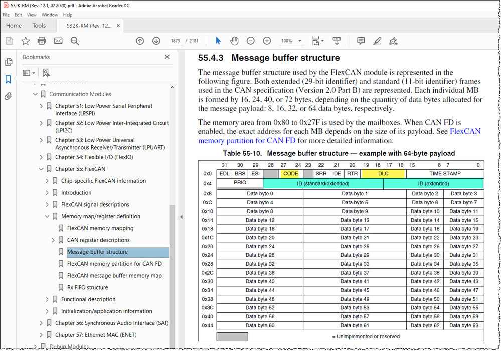

Ok I understand how the variables of Identifier, Data are stored. Finally I have the last question: I saw on the RM, that the CODE for the reception of Message (page 1719) could assume different values, but in RM there isnt't the meaning of 0111. I ask you this because in the function FLEXCAN Receive there is:
(CAN0->RAMn[ 4*MSG_BUF_SIZE + 0] & 0x07000000) >> 24
0x07000000, that means that CODE is equal to 0111. I don't understand this.
At the end, I want to know how to establish the dimension of variable #define MSG_BUF_SIZE 4. In this example, is there four because are transmitted 32 bit as data field??
