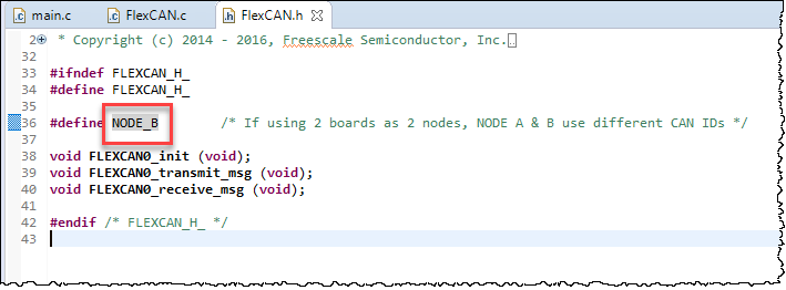

If you want to only receive CAN Message with the ID 0X555, you can direct #define NODE_B in FlexCAN.h.(The codes has configure check all ID bits and allow 0x555 by default.)

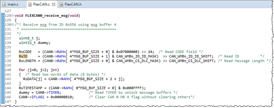

The ID of CAN message(RxID) will be read in FLEXCAN0_receive_msg.

Robin could I ask you some things about CAN that I didn't understand? In the function FlexCAN_receive_msg I don't understand how the variable RXCODE, RXID are stored. I don't understand what means 4*msg_buf_size + 0 or +1. I'm studying the chapter of CAN on RM but I have some difficulties.

Ok I understand how the variables of Identifier, Data are stored. Finally I have the last question: I saw on the RM, that the CODE for the reception of Message (page 1719) could assume different values, but in RM there isnt't the meaning of 0111. I ask you this because in the function FLEXCAN Receive there is:
(CAN0->RAMn[ 4*MSG_BUF_SIZE + 0] & 0x07000000) >> 24
0x07000000, that means that CODE is equal to 0111. I don't understand this.
At the end, I want to know how to establish the dimension of variable #define MSG_BUF_SIZE 4. In this example, is there four because are transmitted 32 bit as data field??
