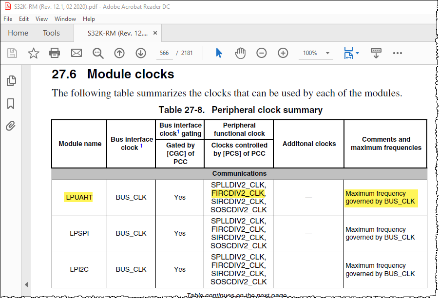

Robin_Shen
Hi sandhyaravikuma,
Would you please let me know the frequency of your BUS_CLK?
According to the "Table 27-8. Peripheral clock summary": Maximum frequency governed by BUS_CLK.
Table 27-8. Peripheral clock summary.pngTable 27-8. Peripheral clock summary.png
If the frequency of BUS_CLK is less than FIRC_DIV2(48MHz), then you can not use FIRC_DIV2 as the Peripheral functional clock of LPUART.
Robin

sandhyaravikuma
My BUS_CLK is 12MHz and FIRCDIV2_CLK is 24MHz. But changing the BUS_CLK to 24MHz gives a warning in Component Inspector. How can I make the change for BUS_CLK?
8,791件の閲覧回数
Robin_Shen
If you cannot modify the BUS frequency, you can consider change a lower frequency Peripheral functional clock.
