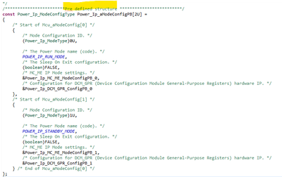

Screenshots of the original structure

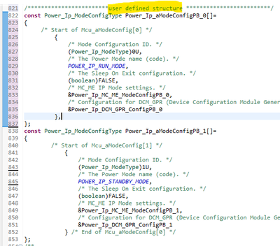

Screenshots of the modified structure

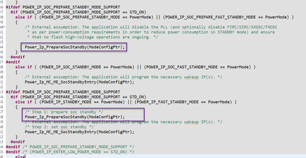

Screenshots of the function call

I am trying to use the 'Prepare for Standby' mode just before entering standby, but I have observed that there is little to no difference in current consumption, whether I use it or not. Could you please help me understand why?
3,136 Views
danielmartynek
Hi @Prasad_330,
Have a look at the source code (Power_Ip.c) to see how the modes are called and what they do.

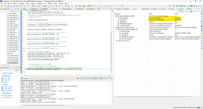

  • I am trying to watch the content of the predefined structure Power_Ip_aModeConfigPB[1] in the watch window.
  • The values displayed are not as expected:
    • ModeConfigId is defined as 1.
    • PowerMode is defined as POWER_IP_STANDBY_MODE (16).
  • However, in the watch window, the values are different:
    • ModeConfigId shows a value of 16795441.
    • PowerMode shows 268435456.
  • For a user-defined structure, the values match what is defined.
  • I have attached a screenshot for reference.
