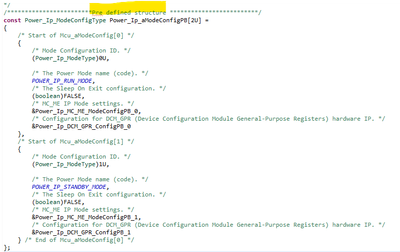

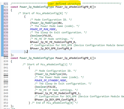

I am encountering a hard fault when using the predefined structure Power_Ip_aModeConfigPB[1] (declared in Power_Ip_PBcfg.c) to enter standby mode with the Power_Ip_SetMode() function. However, when I copy the structure and assign it a different name, Power_Ip_aModeConfigPB_1[0], it works as expected.
I am using the S32K324 controller for this setup.
Screenshots of the original structure
Screenshots of the modified structure

Thanks  Danielmartynek,
The issue was caused by the use of #pragma pack (1), and the problem occurred because I wasn't using the unpack directive in the other folder. The hard fault issue is solved

  • I am trying to watch the content of the predefined structure Power_Ip_aModeConfigPB[1] in the watch window.
  • The values displayed are not as expected:
    • ModeConfigId is defined as 1.
    • PowerMode is defined as POWER_IP_STANDBY_MODE (16).
  • However, in the watch window, the values are different:
    • ModeConfigId shows a value of 16795441.
    • PowerMode shows 268435456.
  • For a user-defined structure, the values match what is defined.
  • I have attached a screenshot for reference.
