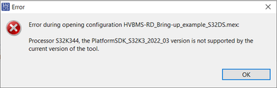

Hi VaneB,
Thank you for the detailed instructions for downloading the v0.9.1 example Bring_Up example source code. However after importing the project into our NXP DesignStudio, double-clicking on the .mex file, led to the error of:

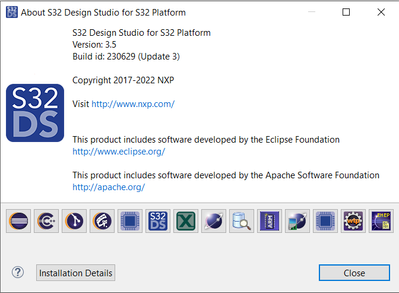

Our NXP DS version is:

Hi @john24
The software was developed using RTD version 2.0.0, supported by S32DS 3.4. So, download this IDE version or install the corresponding RTD version (S32K3 Standard Software > Automotive SW - S32K3/S32M27x - Real-Time Drivers for Cortex-M > S32K3 Real Time Drivers Version 2.0.0).
NOTE: the functionality of the software in a different tool version is not guaranteed.

john24
Thank you again, VaneB, for the good information. We will consider downgrading what we already downloaded and installed, RTD v3.0.0/NXP DS v3.5, in order to get the v0.9.1 Bring_Up example project going.
In the meanwhile, do you see any issue if we update/flash the RD-HVBMSCTBUN eval kit, specifically the RD-K344BMU eval board in it, to the newer version of Bring_Up example found in 'SW32K344_HVBMS-RD_Bring-up_Example_S32DS_1_0_2_D2401.zip'?

Hi @john24
The HVBMS-RD Bring-up Example 1.0.2 was tested using RTD 3.0.0, so, you should not have any problems with this software version.
