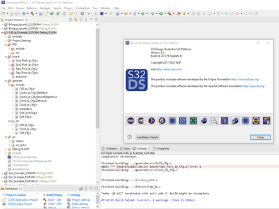

before compilation - I open *.mex file and "Update code". Fix absent PIN SDK files.
I found "Siul2_Port_Ip_Defines.h" - is missed.
After copy this file from another project - It can run.

when I import this project (exactly from same repository version you point on your picture) to S32 Design Studio - it cannot be compiled.

Senlent
Hi@paulffff
you can find C40_Ip_Example_S32K344 in your S32 DS if you already installed the RTD package.
for you better understand the s32k3 memory, you can take a look at the application AN13388 also.
https://www.nxp.com/webapp/Download?colCode=AN13388&location=null
