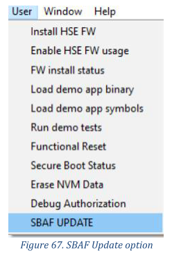

lukaszadrapa
If you use scripts from the demo app, you can just select in T32:
 The SBAF can be found here:
c:\NXP\HSE_FW_S32K3XX_0_2_6_0\hse_full_mem\sbaf\bin\s32k3x2_Secure_Baf_0.13.0_0.9.0_pb220502.bin.pink
Or it is described in the HSE Firmware Reference Manual in section 12.7 Secure-BAF update.
In short, it's necessary to load the pink file somewhere to flash and then call service HSE_SRV_ID_SBAF_UPDATE.
Lukas
