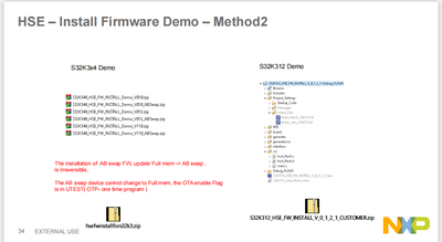

After S32K312_HSE_FW_INSTALL_V_0_1_2_1 is debugged, APP code cannot be burned?

Hi @WXM
because part of the flash is reserved exclusively for HSE after FW installation, it is necessary to change the flash programming algorithm like on the attached screenshot. Then the Pemicro knows that it should not touch these areas and it will work as expected.
Lukas
6,692件の閲覧回数
WXM
The version information is successfully obtained, indicating that the installation of HSE is successful???
