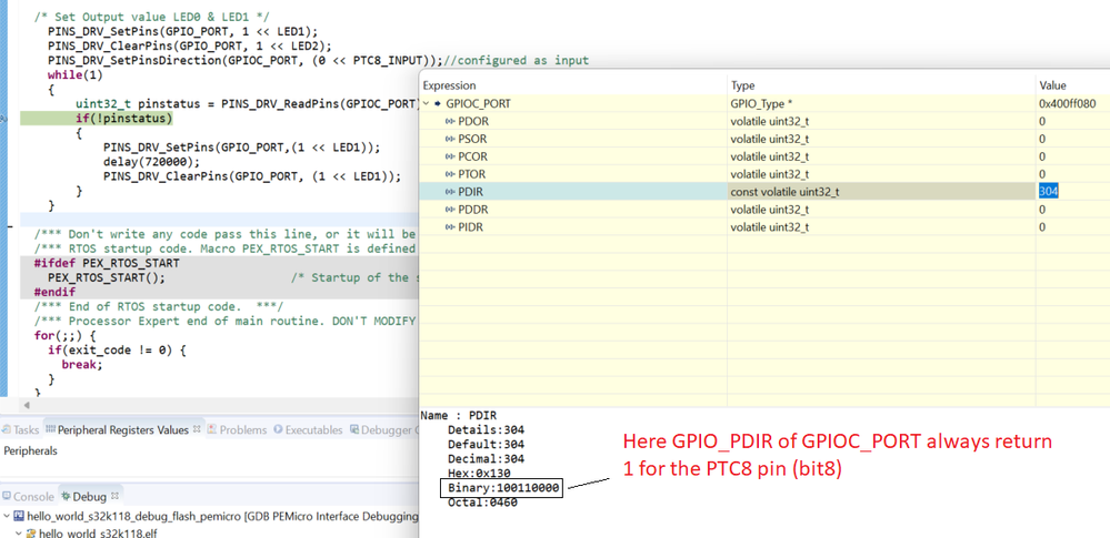

AVND
Hi Robin,
           PINS_DRV_ReadPins function always return 1 for corresponding GPIO pin which is configured as input or else always return 0 if configured as output. Is this correct? For input configuration it didn't  change the pin value to zero for short circuiting the configured pin with Ground.

Robin_Shen
How about direct read the value of GPIO_PDIR?
When pin is configured as input with internal pull down enabled, then test PINS_DRV_ReadPins.
When pin is configured as output and output high or low, then test PINS_DRV_ReadPins.

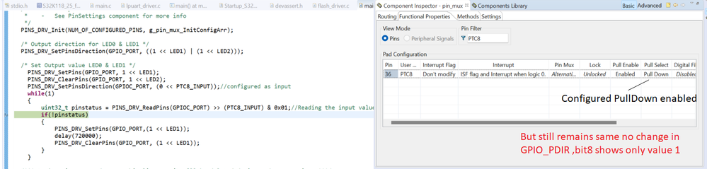

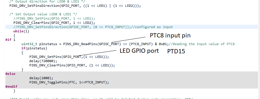

AVND
yes PIN_DRV_ReadPins function return the GPIO_PDIR value,
this is how i have read the PTC8 pin status
//Reading the input value of PTC8:
uint32_t pinstatus = PINS_DRV_ReadPins(GPIOC_PORT) >> (PTC8_INPUT) & 0x01;
15,879件の閲覧回数

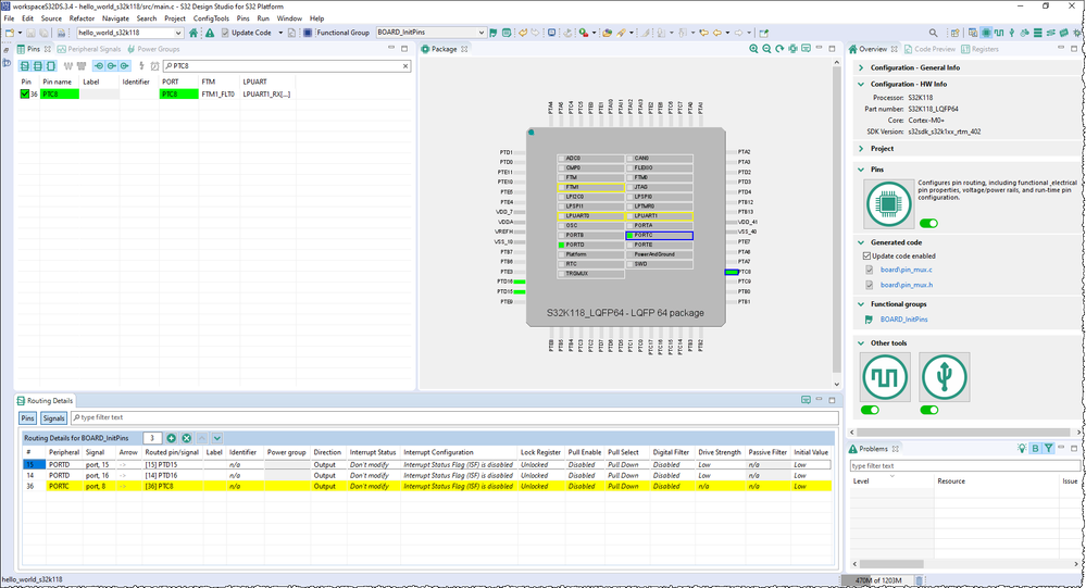

15,877件の閲覧回数
AVND
Hi Robin,
This is what i want to works like push button configuration,
1.Initially PTC8 pin is in zero state value
2.When interrupt came(e.g.,PTC8 pin connecting with VCC) the value become 1.

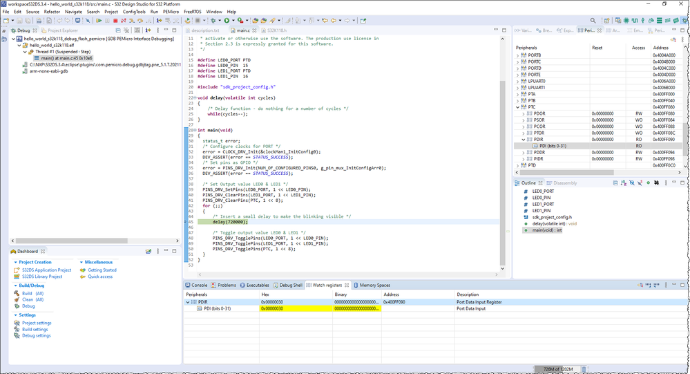

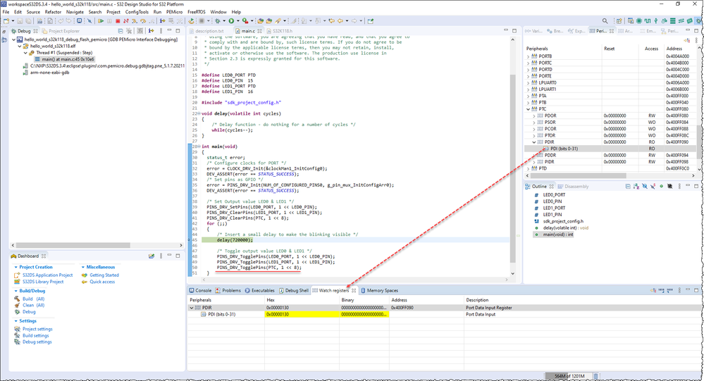

15,860件の閲覧回数
Robin_Shen
Configure PTC8 as output, and able to see the PDIR change with toggle.
Why you configure PTC8 as input but call PINS_DRV_SetPins and PINS_DRV_ClearPins.

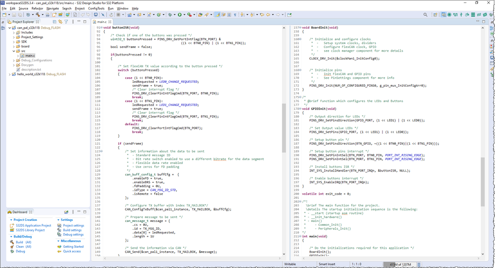

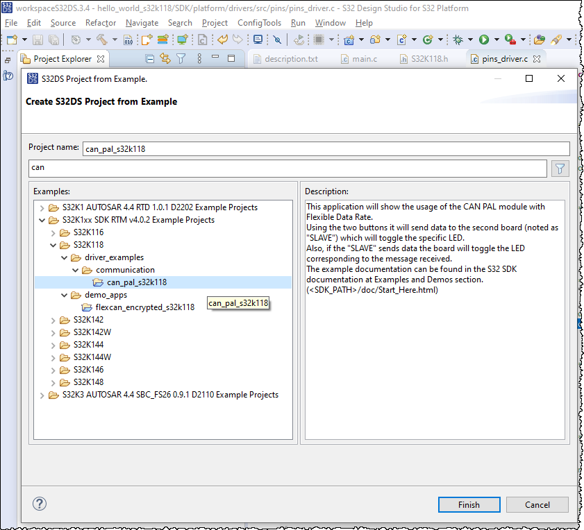

Robin_Shen
So you just want the external voltage connect to PTC8, and trigger PORT interrupt, then output value to other pins?
In short, you want to implement the PTC8 pin interrupt and control the output level of other pins in the pin interrupt?
Please refer the button interrupt in can_pal_s32k118 example:
15,825件の閲覧回数

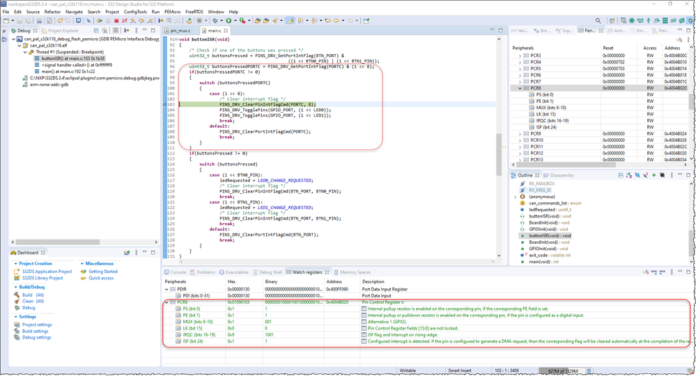

AVND
Hi Robin,
           Yeah this button interrupt (can_pal) code does what i need, but when i configured PTC8 pin instead of both button pin PTD3 and PTD5,interrupt is not triggered what will be the problem? Do you have any idea?
15,819件の閲覧回数
AVND
Even i configured PTD2 pin for interrupt it works fine like button pins, but PTC8 pin not get triggered.why its not get triggered?
15,765件の閲覧回数

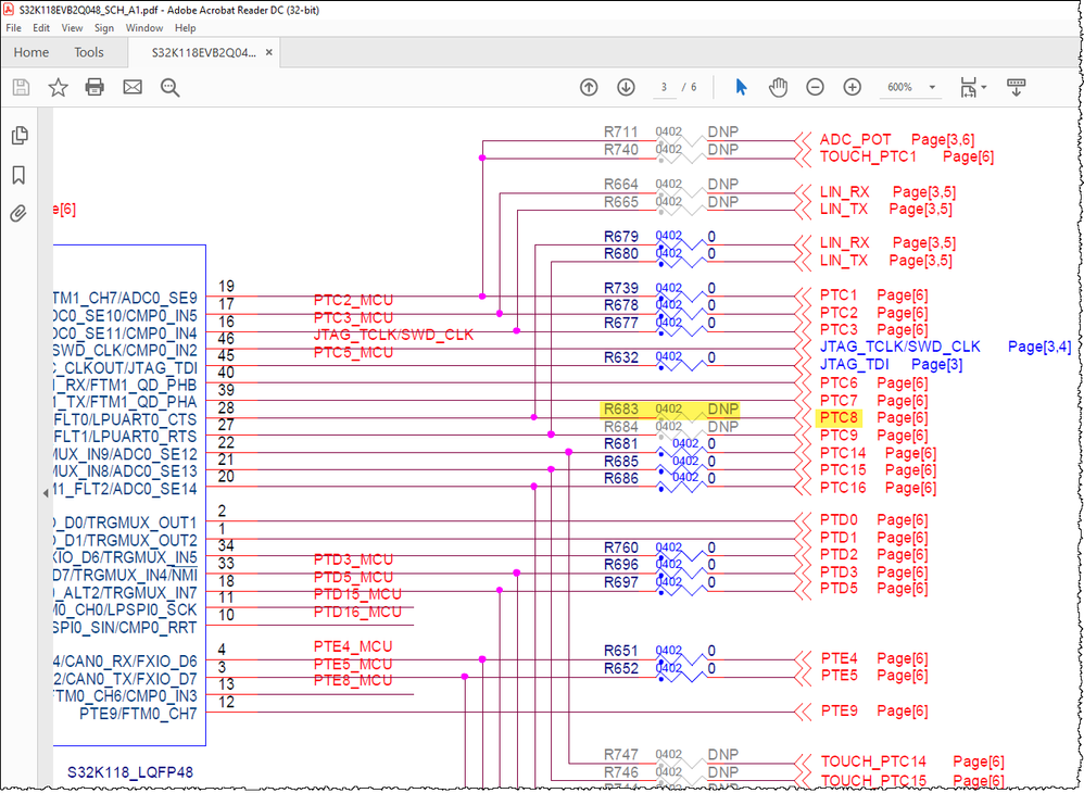

Robin_Shen
S32K118EVB Q064 or S32K118EVB2Q048 are you using?
The R683 is DNP, so the signal did not route to PORTC 8 by default.
I am able to trigger PORTC 8 interrupt, test on S32K118EVB.
15,759件の閲覧回数
AVND
Then how did you get the interrupt for PTC8?
15,760件の閲覧回数
AVND
I am using S32K118EVB2Q048,
so because of  R683 is DNP, i cannot able to get the interrupt for the pin?
