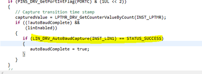

I am working on s32k116 controller and using LIN stack from NXP. Our device is configured as slave.
If Master and slave are powered ON simultaneously and communication starts, Slave is responding properly.
But, If slave is powered ON and Master is in sleep mode. Our slave goes to sleep after 4 seconds(timeout), Now, If we start the transmission from master, slave is not responding. If we start the transmission within 4 seconds then slave is responding as expected.
while debugging we observed that autobaud capturing is not successful in the issue scenario.
5,093 Views
Pavani
 while debugging I have observed that autobaud calculations are not done properly. so I disabled autobaud in LIN stack component. Now all the conditions which I mentioned above are working fine.

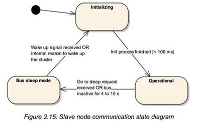

Q: But, If slave is powered ON and Master is in sleep mode. Our slave goes to sleep after 4 seconds(timeout), Now, If we start the transmission from master, slave is not responding. If we start the transmission within 4 seconds then slave is responding as expected.
[Diep] According to the lin spec, because the slave node goes to sleep mode, so the master node must send a wake-up signal before sending any frames on the bus.
Please refer chapter 2.6 of LIN_Specification_Package_2.2A.pdf for more detail.
If the issue is still not resolved, please share your project and then I will try to check on my site.
