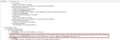

Are you using the evaluation boards for this example? Please keep in mind the connections for this project:
The CAN bus is configured at 500kbps and a CAN ID of 4. If you are using BJB_CAN, then SPI is not needed. Could you clarify what are you referring to when saying "cannot get signal"?

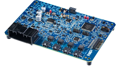

My hardware environment is the following EVB board, and pin define is S32K358_172MQFP
1. I can use "Phy_665a_example_S32K358_CANFD_DS" this example code to sent Can tx message by BJB_CAN, and I can get signal from PCAN-VIEW can analyzer.
2. I want to create a can function just like "Phy_665a_example_S32K358_CANFD_DS" on a new project, so I need to create port, platform, canif, Dio, Flexcan... setting. After I create these MCAL setting, I can't get can signal by can analyzer
3. About the Can transceiver work on normal mode, I only need to write "Dio_WriteChannel(DioConf_DioChannel_BJB_CAN_STBY, STD_LOW)" if I want to use BJB_CAN, right?
What information I need to provide to you and let you help me to figure out what's the problem? I stuck here for many days, please help me, thanks.
