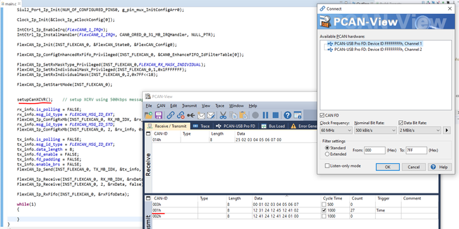

Hi, Sirs,
Please help us as following, Thanks.

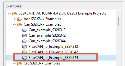

  • sample code: FlexCAN on S32K344

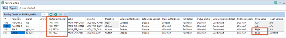

(2) Pins config. :
  • our config.

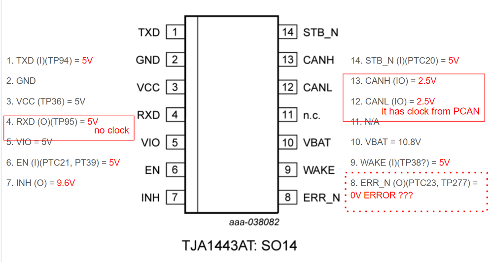

  • EVB user manual: PHY is TJA1443.

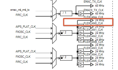

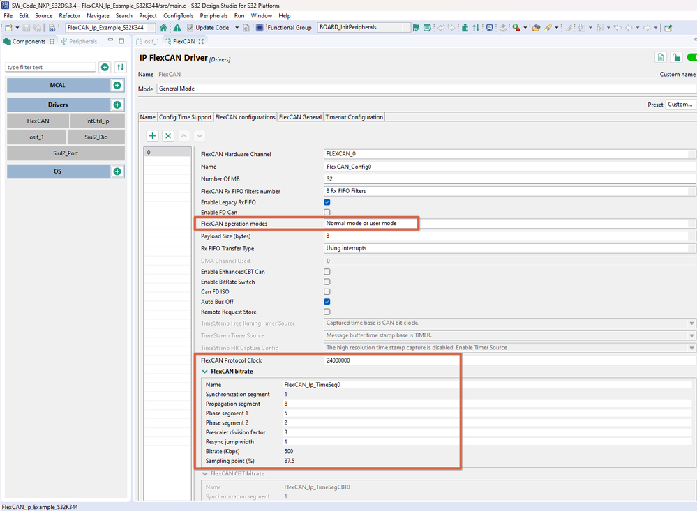

(3) clock config. : 24MHz
(4) Peripherals config. :
  • FlexCAN:

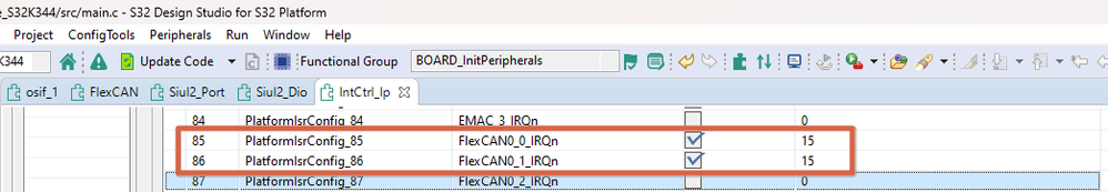

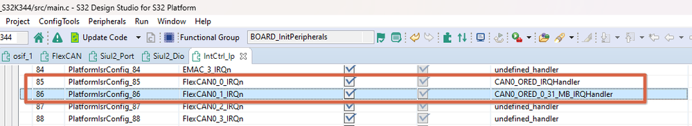

  • Interrupt:

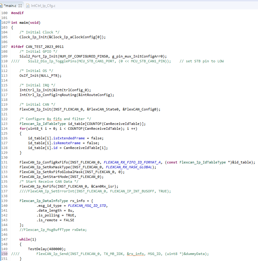

(5) main.c

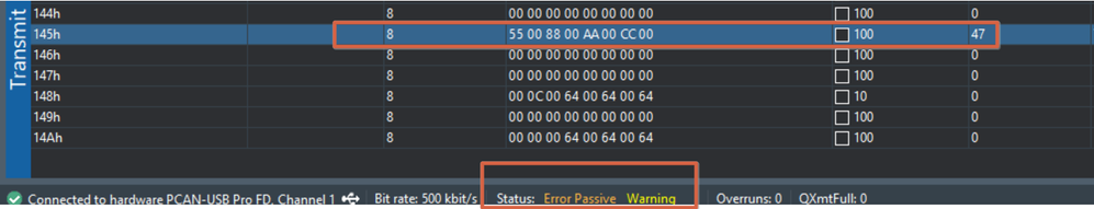

(6) result is NG : check PHY TJA1443 & connect with PCAN
  • measured each pins of PHY
  • used PCAN to send package:

Hi@Jireh
TJA1443 needs to do some configuration first.
please refer to this demo posted by Peter.
(the can transceiver on this demo is TJA1153, which is similar to TJA1143 I guess)
https://community.nxp.com/t5/S32K-Knowledge-Base/Example-S32K344-FlexCAN-Ip-TX-RX-EnhanceRXFIFO-test...
It worsks fine on myside.

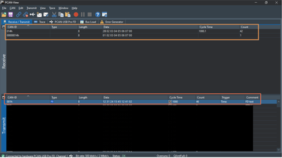

Jireh
thanks a lot, it was working~ (CAN FD)
then, I'm going to check what's the difference with FlexCAN example (CAN only).
