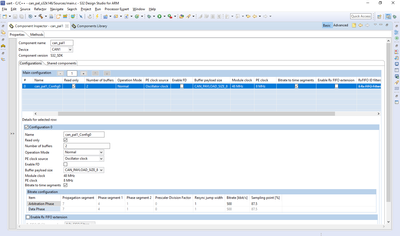

Do you have two S32K146EVB? Try to flash one as MASTER and another as SLAVE(change the /*#define MASTER*/
 #define SLAVE).
Will these two board work?
I don't have CAN Analyzer or oscilloscope on hand, so can not test or measure the waveform.
Does your CAN Analyzer support CAN FD? If not, please change the program disable CAN FD.

ArunkumarV
Hi Robin,
Thanks for pointing the right configuration, it works well after changing the FD.
