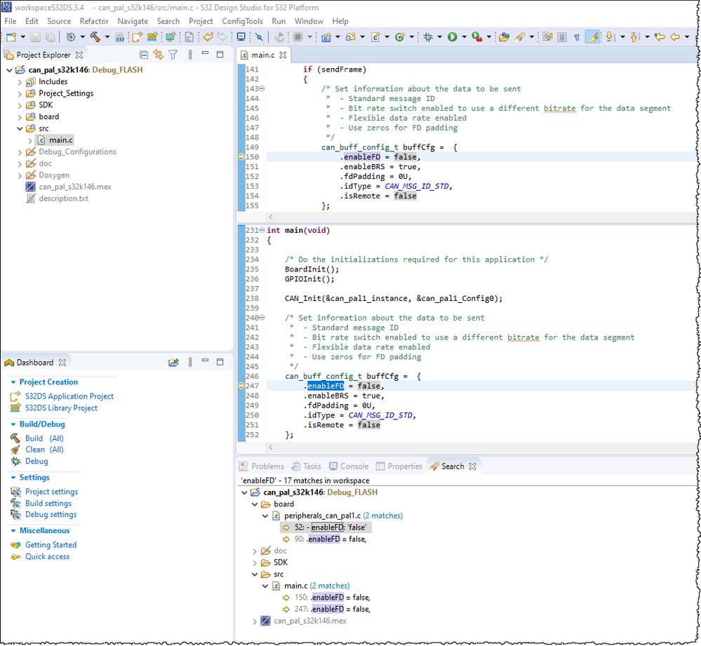

Do you have two S32K146EVB? Try to flash one as MASTER and another as SLAVE(change the /*#define MASTER*/
 #define SLAVE).
Will these two board work?
I don't have CAN Analyzer or oscilloscope on hand, so can not test or measure the waveform.
Does your CAN Analyzer support CAN FD? If not, please change the program disable CAN FD.

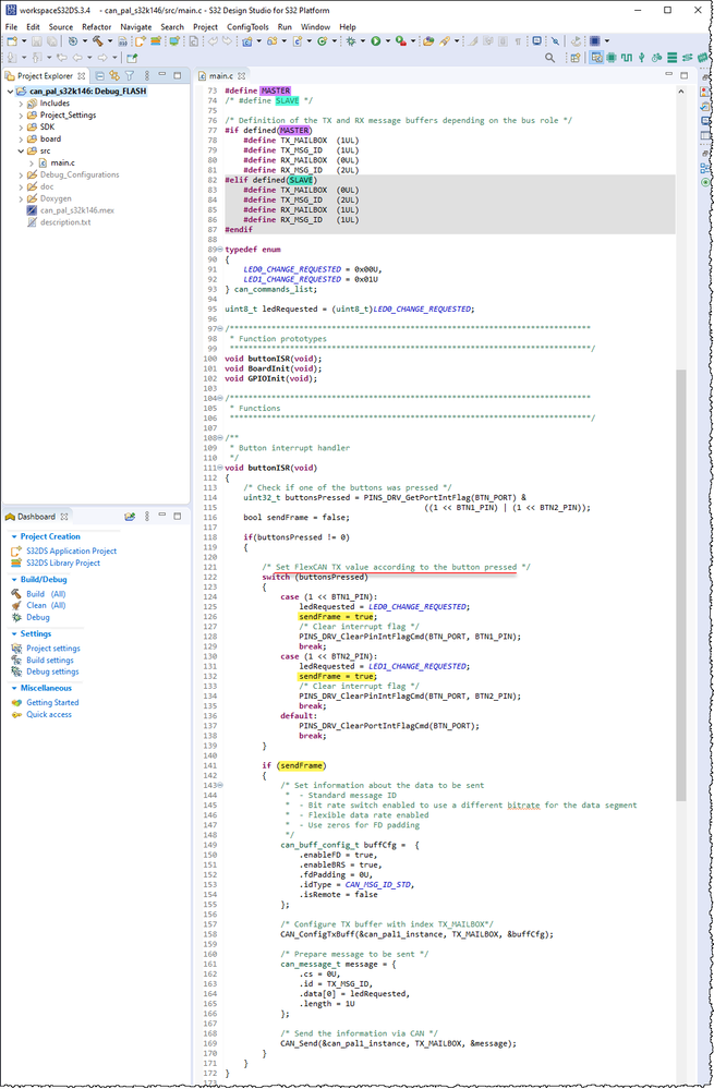

Assuming you are using can_pal_s32k146 example in S32K1xx SDK RTM v4.0.2 with S32K146EVB.
description can_pal_s32k146 RTM4.0.2.pngdescription can_pal_s32k146 RTM4.0.2.png

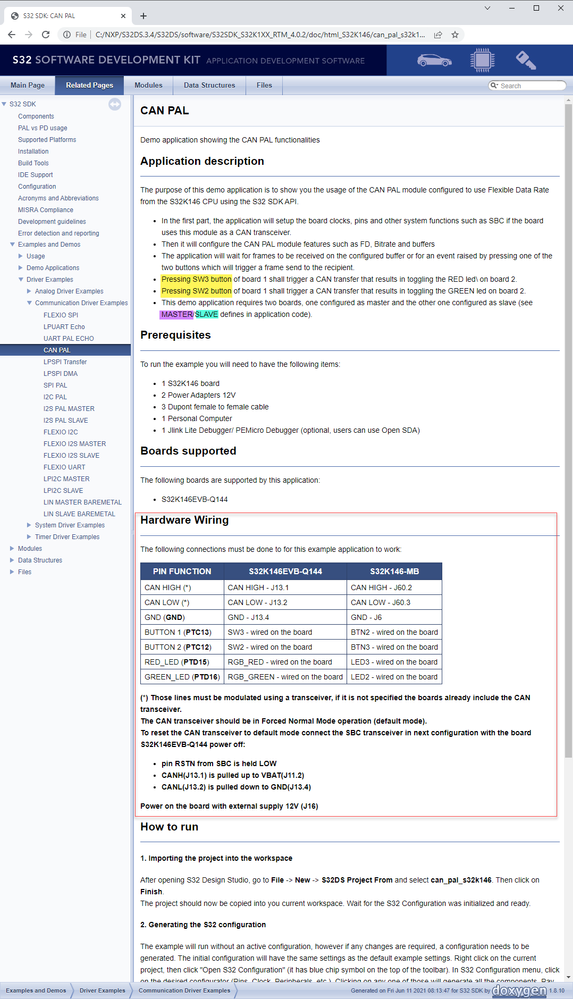

According the the description.txt, please open example documentation(CAL PAL notice the Application description and Hardware Wiring
CAN PAL RTM4.0.2 can_pal_s32k146.pngCAN PAL RTM4.0.2 can_pal_s32k146.pngcan_pal_s32k146 MASTER SLAVE button.pngcan_pal_s32k146 MASTER SLAVE button.pngcan_pal_s32k146 Pins.pngcan_pal_s32k146 Pins.png
Did you press SW2(PTC12) or SW3(PTC13) buttons?
Would you please point out where is the CAN_1 Tx pin? That example select PTE5 as CAN0_TX.
 #define SLAVE).

22,675件の閲覧回数
ArunkumarV
Hi Robin,
Thanks for pointing the right configuration, it works well after changing the FD.
