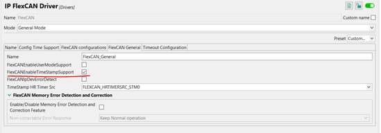

  • How can I activate HR timestamp as seen at below? I am using RTD 3.0.0 with S32DS 3.5

Q3.How can I activate HR timestamp as seen at below? I am using RTD 3.0.0 with S32DS 3.5
a.You need to enable the following options:
b.You need to configure Stm for HR timestamp.(ps,:you can refer to "Stm_Gpt_Example_S32k344")
c.Read HR timestamp, for example:
temp = (uint32)IP_CAN_0->HR_TIME_STAMP[mb_idx];
Also,You can enable the interrupt of Stm and record the number of overflows of Stm
