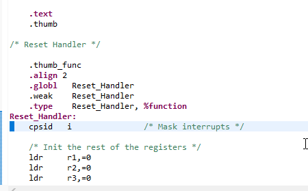

Today after initializing the ADC module i added another line, to utilize the Hardware Interleaved Channels like below
SIM->CHIPCTL = 0x04;
After flashing and running the debugger, reset has observed as control jumped to reset handler like belowpastedImage_1.png

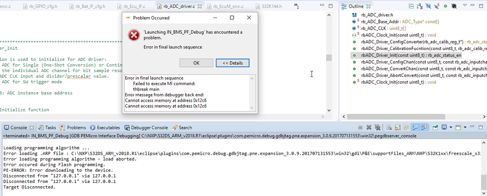

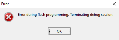

After this i couldn't able to flash the SW, i'm getting below error
Please let me the the solution to flash the device again.
