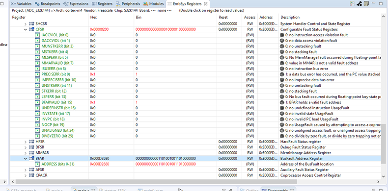

Can you please debug this fault again:
https://community.nxp.com/t5/S32K-Knowledge-Base/Fault-handling-on-S32K14x/ta-p/1114447
What is the content of the CFSR / BFAR registers?
Can you find the instruction that triggers the fault?
BR, Daniel
6,085 Views
hajianik
Senior Contributor I
Below is a snapshot of the registers.
also the instruction that'll trigger Hardfault_handler
Koorosh
That's when I try to read the address at fault(0xD2680 that's what BFAR is showing.
6,053 Views

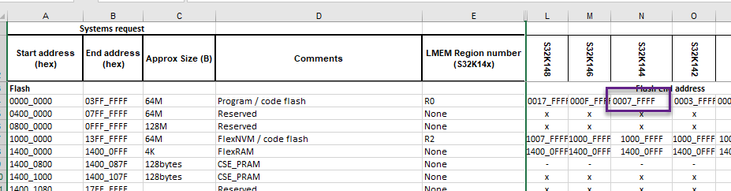

danielmartynek
Hi @hajianik,
There is an obvious error, the address that you are writing to is no implemented on S32K144.
But even with this being fixed, it does not workm and I can't find out why.
Anyway, the test project attached works as expected.
So my target is S32K148. the address 0XD2680 is implemented on this version.
I can not find any error in my code as you looked at it AND COME TO THE SAME CONCLUSIN.

I get identical reporting on the registers that you posted in your last reply.
However when I do the following I get HARD_ FAULT_ exception  rather than a BUS_FAULT_ exception.
  1.  writing a program phrase to a location in flash(64bit aligned)
  2. without erasing the sector, I write a different program phrase to the same location.
  3. when I read the location ,it  will  set the double fault bit  in FTFC_FERSTAT and generates a hard_fault exception even when bus_fault is enabled in SCB_SHCSR register !!!!!
  4. SCB_CFSR REPORTS THE SAME VALUE AS YOU POSTED IN YOUR LATEST REPLY!!!!
  5. I do enable the DFDIE in FTFC-FERCNFG register but it never triggers because of the HARD_FAULT EXCEPTION triggers.
  6. When inside the hard_fault exception I have a valid stack( R13 and r13_MSR are pointing to the main stack and are identical however R14 points to 0xfffffff9 which is la la land.
At this point I'm confused why the hard_fault exception triggers rather than the bus_fault when it is enabled?
