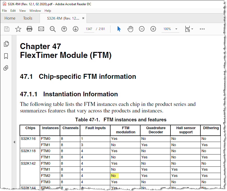

I'm trying to develop a PWM modulation with FTM2 for the S32K142 device. But it looks like the modulation doesn't work for FTM2 as per the below screenshot.
Kindly confirm the same.

I have check it in the latest S32K1xx MCU Family - Reference Manual (REV 12.1).
Still get the same information as the table that you found.

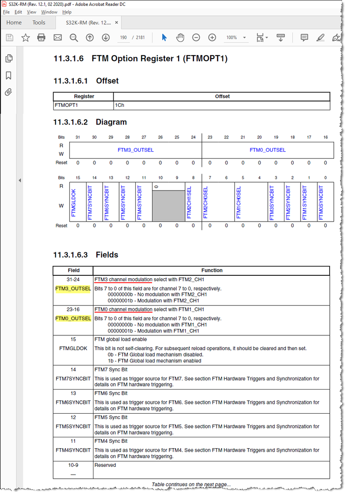

And I can only find the FTM0_OUTSEL and FTM3_OUTSEL bit.

As suggested, does it mean I can use only Channel1 alone (FTM1-CH1 & FTM2-CH1) or all FTM channels from CH0-CH7.
In other words, If I initialize FTMOPT1->FTM3_OUTSEL=0xFF; I can implement all FTM1CH0-7 signals withour initializing FTM0.
