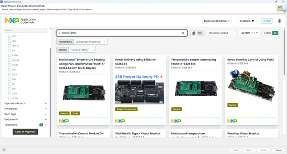

Hi@Veereshh
You can find a lot of demo from "Import Project from Application Code Hub"
However, it should be noted that the RTD version used in these demos is the latest one.

I reviewed the Application Code Hub example "Motion and Temperature Sensing using LPI2C and GPIO on FRDM-A-S32K344 with MCAL Drivers" and started following the implementation steps.
However, I noticed that my S32 Design Studio v3.5.8 does not show the "Import Project from Application Code Hub" option in the Dashboard after opening the workspace, while it is available in the screenshot you shared.

Senlent
Hi@Veereshh
The version of S32 DS you are using is too old; you should install the latest version, as older versions do not include the "Code Hub" option.
