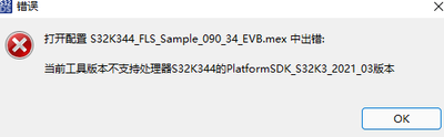

I use the  JLink V9 to debug ,Is it because this device mismatch S32K344?
And I cannot open you mex file
There is an error message
This version tool cannot support processor Platform_SDK_S32K3_2021_03

Senlent
Hi@tianxing
      Sorry,forgot to tell you,this example is works on S32 RTD AUTOSAR 4,4 Version 0.9.0(old version).
      you can download the old version, or I may need to take some time to port this example to the new version.
