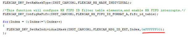

I'm working on S32K144 CAN peripheral in which I'm using RX FIFO filter to receive data from multiple ID's.
In which masking is used to achieve ID range.
-> 0x404 is masked with 0x7FC thus lower 2 bits are don't care, so messages with ID 0x404-0x407 are received
-> 0x420 is masked with 0x7F0 thus lower 4 bits are don't care, so messages with ID 0x420-0x42F are received
Now If I want to receive multiple can ID's
Ex. 0x11111110, 0x12222210, 0x13333310 and so on.
In this ID lower 8 bits are same and other bits are don't care.
so how to achieve this using masking?

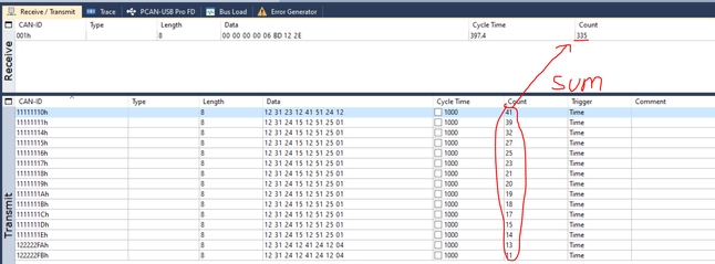

I checked and reproduced your problem, what i want to say is that this is not a software problem but that you overestimated the communication rate.
you can see that the bus load rate is close to 100%

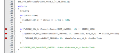

-> I'm using FLEXCAN0 so instance = 0;
-> I've configured RXFIFO to receive FLEXCAN data.
flexcan_msgbuff_t RxBuff;
FLEXCAN_DRV_RxFifo(instance, &RxBuff); // called in flexcan0_Callback
-> To send data I'm using TX_MAILBOX = 15;
flexcan_data_info_t BuffCfg;
BuffCfg.data_length = 8;
BuffCfg.enable_brs  = false,
BuffCfg.fd_enable   = false,
BuffCfg.fd_padding  = 0U;
BuffCfg.is_remote = false;
BuffCfg.msg_id_type = FLEXCAN_MSG_ID_EXT;
flexcan_msgbuff_t TxBuff;
TxBuff.dataLen = 8;
memset(&TxBuff.data[0], 0x10, 8);
TxBuff.msgId = 0x10000001;
// Sending in 10mS using RTOS Task
if(FLEXCAN_DRV_GetTransferStatus(instance, TX_MAILBOX) != STATUS_BUSY)
if((FLEXCAN_DRV_ConfigTxMb(instance, TX_MAILBOX, &BuffCfg, 0)) == STATUS_SUCCESS)
FLEXCAN_DRV_Send(CAN0, TX_MAILBOX, &BuffCfg, TxBuff.msgId, TxBuff.data);
-> Here I'm using TX_MAILBOX = 15 for sending data and I'm getting TransferStatus = STATUS_BUSY always.
And then FLEXCAN is not sending any frame.
I'm not able to understand this.

here is my test code without using FreeRTOS and it works find on myside
So could you please test this case without using FreeRTOS, if the result is same with mine, then I think this might be an issue with your freertos.

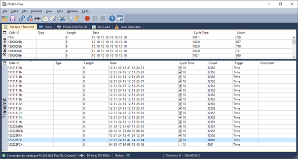

I'm sending 10 frames with 10 different ID's in 10mS (from Flexcan0 to CAN tool) and simultaneously receiving other frames using flexcan callback. (i.e. Sending frames from CAN tool to S32K144 Flexcan0 in 10mS)
If I'm Sending 16 or 17 frames from CAN tool in 10mS then this code works fine, Flexcan0 is able to send 10 frames to CAN tool.
But if I'm Sending more than 16 or 17 frames from CAN tool in 10mS then flexcan0 stops sending frames to CAN tool. I'm getting MB transfer state = STATUS_BUSY.
If Flexcan0 is receiving more than 16 frames then it is not able to send any frames till I reduce no of frames sending from CAN tool.

please refer to this post.
https://community.nxp.com/t5/S32K-Knowledge-Base/S32K1xx-FlexCAN-Mask-Setting-Demo/ta-p/1519753
for example:
format A, individual mask ,extended frame,mask value set to 0xFFFFFF00
