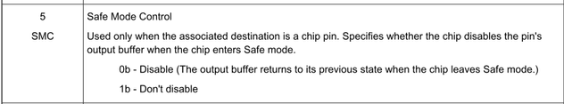

I spend some time on further testing, and the issue is in pin control in safe mode.
SIUL2. MSCR [SMC] - pins are not controlled in safe mode (fault state) if the SMC is not set to 1.
After I have set SMC = 1 the FCCU fault protocols propagate correctly on the EOUT pins.
Let me know if it solves the issue.
Peter

petervlna
Peter

mikegly
Thanks for the help Peter, this worked!

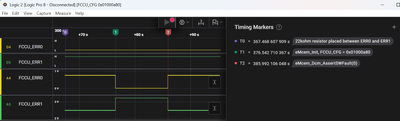

mikegly

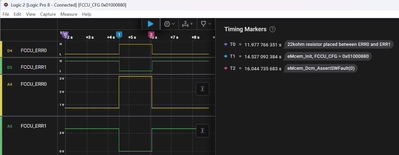

Thanks Peter. It looks like I'm seeing that the EOUT output is open drain when in the faulted state. And that seems to be the case whether OBE output buffers are enabled or disabled.
To test this, I put a 22Kohm resistor between ERR0 and ERR1. So that I would see voltages other than 0v and 3.3v any time the EOUT pins are hi-z. If you look at the red "2" timing marker in both of these screenshots, you'll see that ERR0 and ERR1 go to hi-z at fault. These screenshots have OBE=0. But I saw the same behavior after re-running the test with OBE=1.
In case my analog sampling was not fast enough to catch a brief push-pull edge, I also tried edge triggering (without the 22Kohm resistor). And I do not see an edge on fault.
I'm using the eMcem driver here.

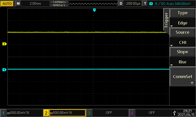

1,720 Views
mikegly
Thanks Peter. It looks like ERR0 and ERR1 pins did not change between your Normal Mode and Fault Mode screenshots, similar to what I see. Why is this? Shouldn't they be changing? Or is there something missing with the configuration?
By the way, I am also doing these two things discussed in the previous support case #00696653 before testing. Were these also set for your measurements above?
1. SSS=1 setting for MSCR143 and MSCR144
2. Non-critical Fault-State EOUT Signaling Enable (EOUT_SIG_EN0 = 0x000000ff)
Thank you

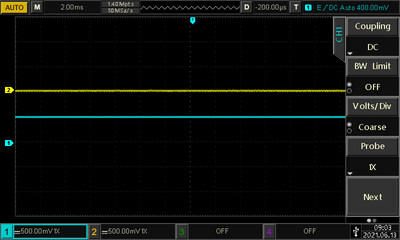

1,691 Views
petervlna
Yes, looks like I have posted twice the same screenshot.

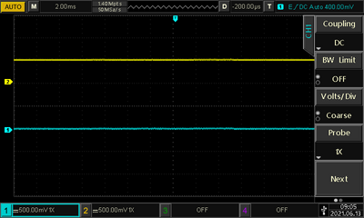

The fault/config mode will have the same behavior (fault) on outputs. To measure this you will need a trigger on oscilloscope to catch the fault state as there is only small time window for fault. Alarm state. Once expired the FCCU or FOSU will reset the device and with it also the pins and config of FCCU.
Yes, this is essential for EOUT signaling.

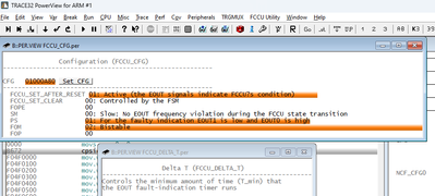

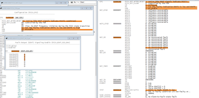

My configuration of FCCU can be seen on debugger screenshots. + the pins config.
Peter

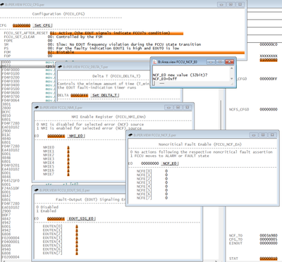

mikegly
Thanks Peter. Maybe there are missing screenshots. In the two which include EOUT_SIG_E0, it is set to 0x00. And I don't see MSCR in any screenshots.

petervlna
I have did the measurement once again.
2. Bi-stable protocol PS=0
Normal
aligned with Reference manual:
Fault -same config as above but NCF_E enabled
2. Bi-stable protocol PS=1
Normal
I am not able to catch the fault state on the scope.
3. Bi-stable protocol PS=0 and CM=1
I will add measurement later when I find out what is the root cause.
Peter

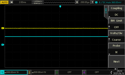

I have did the measurements:
Here are the results:
1. BI-stable protocol PS=1
and measurement:
and measurement
 3. Bi-stable protocol PS=0 and SM=1
normal mode
Fault mode
Peter
