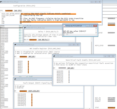

Hello, I'm trying to test EOUT output on an MR-CANHUBK344 board.
Before calling eMcem_Init, the pulldown keeps FCCU_ERR0 at 0v, and the pull-up keeps FCCU_ERR1 at 3.3v.
If I set FCCU_CFG to 0x01000080 or 0x01000880 using eMcem_Init, EOUT behaves how I would expect:
1. FCCU_STAT starts at 0x10
2. ERR0 changes to 3.3v, and ERR1 changes to 0v
3. I call eMcem_Dcm_AssertSWFault(0)
4. I see that ERR0 changes to 0v, and ERR1 changes to 3.3v
5. I see that FCCU_STAT is now 0x2B (fault state)
But if I set FCCU_CFG to 0x01000280 or 0x01000A80, I do not see EOUT respond:
1. FCCU_STAT starts at 0x20
2. ERR0 stays at 0v, and ERR1 stays at 3.3v (no change, which is expected)
4. I see that ERR0 and ERR1 do not change (I don't understand why)
5. I see that FCCU_STAT is now 0x1B (fault state)
What am I missing in the 0x01000280 or 0x01000A80 cases? I had expected ERR0 and ERR1 to change levels at the time of fault.

I spend some time on further testing, and the issue is in pin control in safe mode.
SIUL2. MSCR [SMC] - pins are not controlled in safe mode (fault state) if the SMC is not set to 1.
After I have set SMC = 1 the FCCU fault protocols propagate correctly on the EOUT pins.
Let me know if it solves the issue.
Peter

mikegly
Thanks for the help Peter, this worked!

Thanks Peter. It looks like ERR0 and ERR1 pins did not change between your Normal Mode and Fault Mode screenshots, similar to what I see. Why is this? Shouldn't they be changing? Or is there something missing with the configuration?
By the way, I am also doing these two things discussed in the previous support case #00696653 before testing. Were these also set for your measurements above?
1. SSS=1 setting for MSCR143 and MSCR144
2. Non-critical Fault-State EOUT Signaling Enable (EOUT_SIG_EN0 = 0x000000ff)
Thank you

petervlna
Yes, looks like I have posted twice the same screenshot.
The fault/config mode will have the same behavior (fault) on outputs. To measure this you will need a trigger on oscilloscope to catch the fault state as there is only small time window for fault. Alarm state. Once expired the FCCU or FOSU will reset the device and with it also the pins and config of FCCU.
Yes, this is essential for EOUT signaling.
My configuration of FCCU can be seen on debugger screenshots. + the pins config.
Peter

mikegly
Thanks Peter. Maybe there are missing screenshots. In the two which include EOUT_SIG_E0, it is set to 0x00. And I don't see MSCR in any screenshots.
