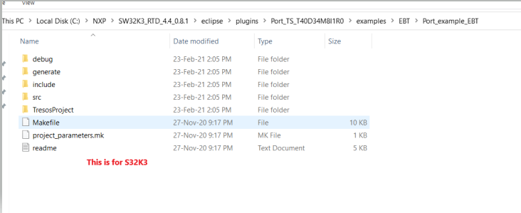

Hi, I am looking for the example for EBT plugins, to test out the configuration. I have the same for S32K3 board but not for the S32K144 board. I have attached an image for the folder structure for S32K3 RTD. I am looking for the same for S32K144 board if available.

Unfortunately, the example for each modules as for K3 is not available for K1 yet. With S32K1xx AUTOSAR MCAL products, we have either the sample application located in each package (e.g. S32K14X_MCAL4_2_RTM_1_0_1\S32K14X_MCAL4_2_RTM_1_0_1_Sample_Application), or the platform integration which should be available here: https://www.nxp.com/webapp/swlicensing/sso/downloadSoftware.sp?catid=SW32K1XX-PTFM01D
