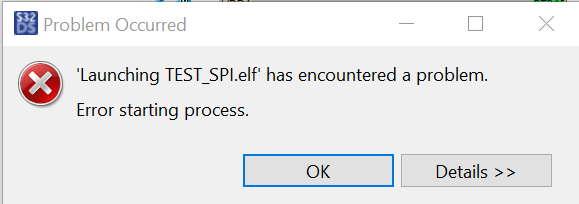

Hi ,I just started working on NXP .
During the working on EVB S32K146, i am debugging using the USB.
but not able to debug.
the IDE shows the below pop up  window and the debugging operation stops immediately.
when i try run / debug the code this window pop-upwhen i try run / debug the code this window pop-up

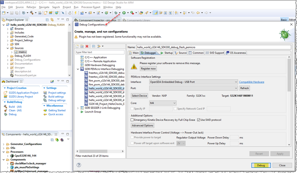

Did you test the S32K1 SDK examples in S32 Design Studio for ARM Version 2.2?
Click Generate Processor Expert Code and then build the project, click debug here:

I have tried that also it shows the "DEVICE IS UNSECURED"
and the stops. ask for processing unsecured.

Try to use P&E Recovery Utility halt MCU, and then you should be able to program it. Refer to: S32K144 D2 RED LED is ON always
