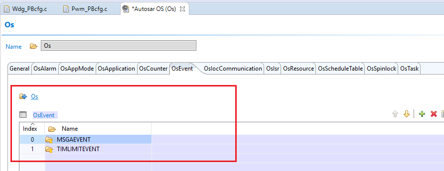

hungnguyenphi
Hello Sandipta Mohanty ,
It seem that you haven't added the value for the OsTaskEvenRef in the configuration. Could you please try to add it.
Note that user also need to add atleast one element in the OsEvent to make the list show in the OsTaskEvenRef
Hung.
