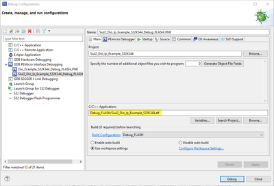

I am using S32DS v3.4 with S32K3X4 T-172 Evaluation Board.
How should I overcome this error of launching the program and flashing it on the board?
What is the procedure for debugging and what type of debugging should be used (for this and all other programs further)?

Are you using an external debugger? Or are you connecting through the USB from the EVB? Please make sure the elf file is correctly declared in the debugger settings:

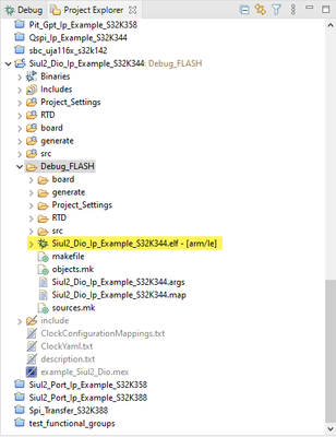

and also make sure the .elf file is correctly generated in the "Debug_FLASH" folder:

Select the configuration to be built: FLASH (Debug_FLASH) by left clicking on the downward arrow corresponding to the build button in eclipse.
        Use Project > Build to build the project.
Wait for the build action to be completed before continuing to the next step. Check the compiler console for error messages; upon completion, the *.elf binary file should be created.

Go to Run and select Debug Configurations. There will be a debug configuration for this project:
        Configuration Name                                    Description
   Siul2_Dio_Ip_Example_S32K344_Debug_FLASH_PNE       Debug the FLASH
                                                      configuration using
                                                      PEmicro probe
Select the desired debug configuration and click on Launch. Now the perspective will change to the Debug Perspective. Use the controls to control the program flow.

Currently I am using the on-board debugger only.
I reached till RUN but in the debugger section, the name  appearred as Siul2_Dio_Ip_Example_S32K344 Debug_FLASH . So, I forcefully changed it to Siul2_Dio_Ip_Example_S32K344 Debug_FLASH_PNE.
And after the debug process this message popped up :
