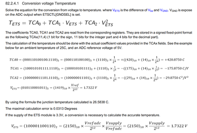

Follow RM, to convert from voltage to temperature:
In this expression, TCA0, TCA1, TCA2 are read-only and normally not change(or change just a little bit) and they have value:
So, in your case TCA0 is correct.

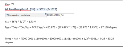

The return value of the function Adc_Sar_Ip_TempSenseCalculateTemp() is in fixed-point format as description below:
Some expressions used to calculate:
For example:
Nhi_Nguyen_2-1696995062041.pngNhi_Nguyen_2-1696995062041.pngNhi_Nguyen_3-1696995151407.pngNhi_Nguyen_3-1696995151407.png
- Conversion resolution
- Reference Voltage, in my case, Vref is 5V.
Seem that there is difference result between expression in RM and driver. I'll contact to SW team and get feedback from them.

I'm getting the value as 1239 from adcgroupresult for the tempsensor channel.
1239*(3.3/4095)=0.9984
So, if i calculate by using this formula, the temperature value will be 200+degree.
How to do this .
12,633件の閲覧回数
Nhi_Nguyen
Hi @Venu_M ,
Did you try to run the example that I attached to previous comment? In my example, Vref = 5 not 3.3V. You can refer to read me to see board used. Because as far as I know, Changing board make default Vref change. You also need to upgrade to the latest version also.
