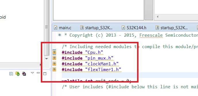

Good evening to everybody.
My name is Pietro, i'm using  S32 Design Studio for ARM Version: 1.2
I'm using an X-FRDMPK144-Q100 NXP Demoboard.
I'm trying to run some EAR driver examples but i can't recognize some header libraries.
The missing files are Cpu.h, pin_mux.h, clockMan1.h and flexTimer1.h
I show you what i see
How can i find that files? There is a particular setup?
Are that examples suitable for my demoboard?
Thank you.

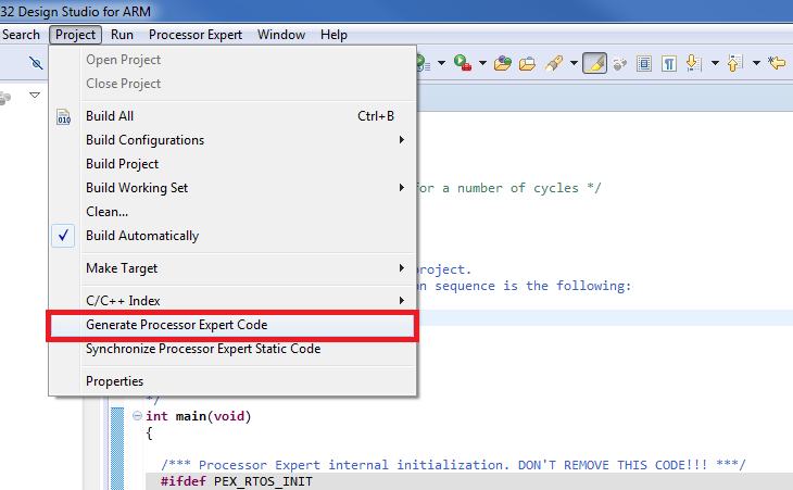

Hi Pietro,
It seems that the ProcessorExpert configuration files are not generated.
You can go in the menu bar and select Generate ProcessorExpert Code under project(Please see the attached picture below). This should generate the necessary configuration structures in order to compile the application.
Please let me know if this was the solution.
Rares
2,463 Views
pietroserao
Thank you so much!
It works now :-)
