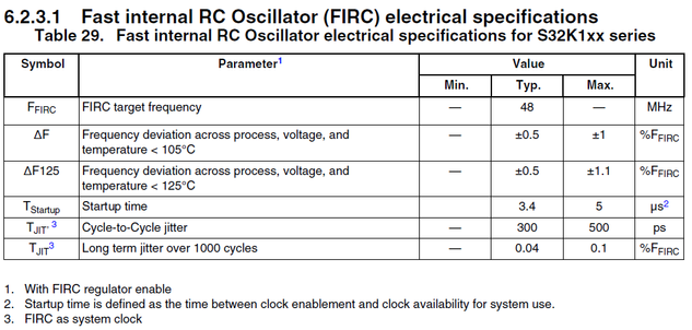

Hello community members,
I am working on S32K, I wanted to disconnect the external oscillator on the HW. I want to just use FIRC as the main clock. But we have issues with this.
I just want to understand, is this possible?
I configured SCG_RCCR to use FIRC. which means the system clock is provided by FIRC. When I had to configure the CAN clock source I selected 1 to use SYS_CLK.
Please provide your inputs.
Thank you

Hello @aboeini,
The SOSC clock is recommended because of the FIRC tolerance.
Please refer to: CAN with Flexible Data-Rate Specification Version 1.0
p. 32 Oscillator Tolerance
FlexCAN Bit Timing Calculation
STEP 6: Calculate required oscillator tolerance
You can use this calculator to calculate the df(%).
MPC5xxx/S32Kxx: CAN / CAN FD bit timing calculation
