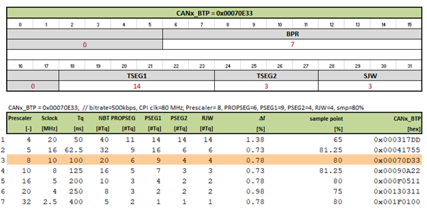

MPC5xxx/S32Kxx/LPCxxxx: CAN / CAN FD bit timing calculation
This tool simplifies CAN bit timing calculation for CAN modules (FlexCAN, MCAN) available on MPC5xxx, S32Kxxx and LPCxxxx families.
Enter input parameters into light green cells.
Device and Transceiver are selected from pull-down menus.
By selecting Transceiver, propagation delay parameter is also loaded, but can be simply overwritten by user value.
Rest of parameters can be modified directly upon user needs.
The tool lists possible setting together with register view.
A recommended setting is highlighted. Three criteria are used for recommended values selection
- desired sample point
- highest fcpi accuracy
- same prescalers for nominal and data phases, if CAN FD is calculated
For sure other setting can be selected, if needed, by clicking on respective line in list.
Note: Macros have to be enabled!

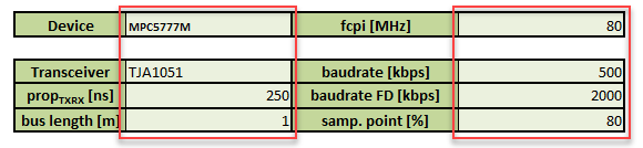

While when I use the tool in this post, I configured parameters as following:
- Device: MPC5748G-CAN FD
- fcpi: 40
- propTxRX: 150
- bus length: 4
- baudrate: 500
- baudrate FD: 1000 (not used, since we only care about arbi rate in this case)
- samp. point: 80
The result was much different with S32DS's. There was no one parameter suite as expected.

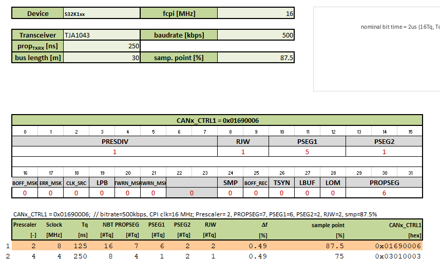

Hi Petr ,
Regarding the sample point that should be configured in the calculator .. If I have two samples points in my project one for arbitration part which is 81.25 % and another one for CAN-FD data which is 60 % so which one should I use when I calculate the timing parameters ?
and other thing is there another version of the CAN bit timing Calculation which supports NXPTJA1057GT Transceiver?

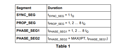

Hello Petr,
thanks for providing that useful calculator!
I have a question though about the (recommended) results, namely:
In this case, it provides me with a recommended result for which the rule in AN1798 (Table1) tPHASE_SEG2 = MAX(IPT, TPHASE_SEG1) does not seem to be followed.
That makes me wonder, if these parameters can still be used or if the second proposal below with 75% sample point is absolutely required?
Note: RJW would then be 1 in my case (J1939).
Thanks in advance for shedding some light on my problem!
