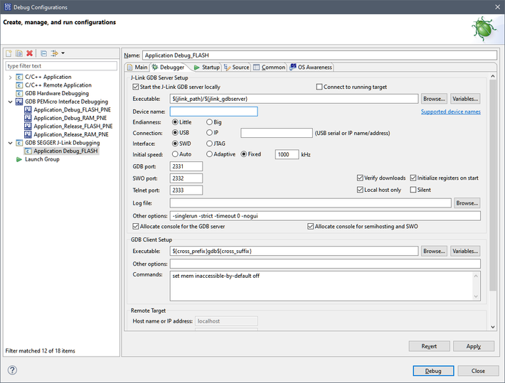

We are attempting to debug a custom hardware based on a S32K142 (FS32K142HAT0MLHT).
Would like to do the debugging with a J-Link Base from Segger in combination with S32 Design Studio for ARM.
When attempting to setup the debug configuration in S32 Design Studio, in the interface that is depicted below, so is there a field called Device name that needs to filled in. What would be suitable to enter in this field when having a S32K142 MCU?
Regards SGR

Hello @ShinyGreenRobot,
In the following link, you can find the list of devices supported by the J-Link debuggers, the name is the one that you need to use in the Device Name box.

ShinyGreenRobot
OK thanks found the name S32K142 in the list of devices so will use that device name in the debug configuration.
