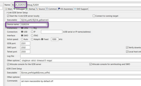

Sathiskumar
First i have debugged with s32k312 onboard PE micro debugger for debugging. After that i have used SEGGER j-link debugger. while debugging i have faced error "Error while launching command: arm-none-eabi-gdb --version ". i also tried to change configurations for debugger.but iam unable clear it. Suggest some solutions to solve this error.
Thanks in Advance...
2,141 Views
danielmartynek
Hello @Sathiskumar,
The Device name does not match the project.
Can you select S32K312?
If not, the plugin in S32DS is probably not updated.
Download and install the up-to-date version of the J-Link Software and Documentation pack
https://www.segger.com/downloads/jlink/
Please close the S32DS IDE before the installation.
During the installation while the IDE is closed, it will ask you to update the S32DS as well.
