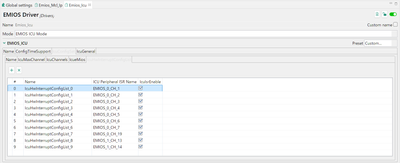

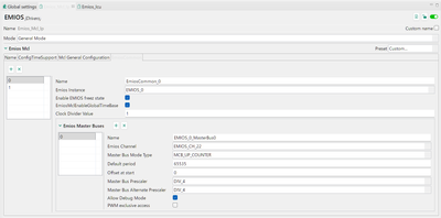

I am configuring software to measure motor pulse width using the Input Capture feature of the EMIOS on the S32K344.
I have set up the driver libraries “Emios_Mcl_Ip” and ‘Emios_Icu’, but code output is not being generated from “Emios_Mcl_Ip_PBcfg.c”.
My understanding is that “Emios_Mcl_Ip_PBcfg.c” generates code based on the settings from “Emios_Mcl_Ip”.
If “Emios_Mcl_Ip_PBcfg.c” does not output code, there is no information to provide to “Emios_Mcl_Ip_Init”.
I will upload the configuration screen and the software. Please advise on the cause.

Thank you for your interest in our products and for contributing to our community.
Please refer to 7. Input Capture Unit (ICU) driver section of the following community post:
S32M27x/S32K3 – eMIOS Usage -> https://community.nxp.com/t5/S32M-Knowledge-Base/S32M27x-S32K3-eMIOS-Usage/ta-p/2129760
We hope this resolves your issue.
