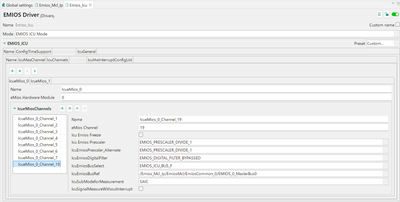

I am configuring software to measure motor pulse width using the Input Capture feature of the EMIOS on the S32K344.
I have set up the driver libraries “Emios_Mcl_Ip” and ‘Emios_Icu’, but code output is not being generated from “Emios_Mcl_Ip_PBcfg.c”.
My understanding is that “Emios_Mcl_Ip_PBcfg.c” generates code based on the settings from “Emios_Mcl_Ip”.
If “Emios_Mcl_Ip_PBcfg.c” does not output code, there is no information to provide to “Emios_Mcl_Ip_Init”.
I will upload the configuration screen and the software. Please advise on the cause.

_Leo_
Thank you for your interest in our products and for contributing to our community.
Please refer to 7. Input Capture Unit (ICU) driver section of the following community post:
S32M27x/S32K3 – eMIOS Usage -> https://community.nxp.com/t5/S32M-Knowledge-Base/S32M27x-S32K3-eMIOS-Usage/ta-p/2129760
We hope this resolves your issue.
