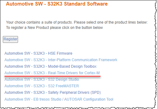

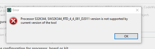

I have a S32K344 project developed by someone else. I have installed what I think is the latest version of the "MCUXpresso Config Tools", the IDE, etc., but the Config Tool will not open the file. There seems to be a version mismatch, but I cannot seem to get the right version of the tool(s). Can someone please provide a link to the right tool? Thank you.
2,716 Views
Robin_Shen

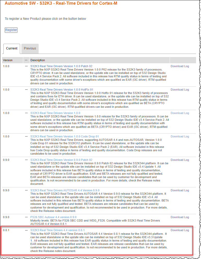

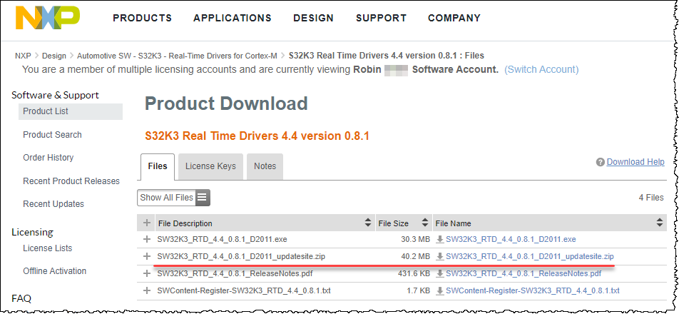

This project is created with old version S32K RTD. Please download the SW32K3_RTD_4.4_0.8.1_D2011_updatesite and install it by refer: HOWTO: S32 Design Studio - Offline Install of Extensions and Updates
Download SW32K3_RTD_4.4_0.8.1_D2011_updatesite.pngDownload SW32K3_RTD_4.4_0.8.1_D2011_updatesite.pngS32K3 Real Time Drivers 4.4 version 0.8.1.pngS32K3 Real Time Drivers 4.4 version 0.8.1.png
Then you will be able to open .mex file.

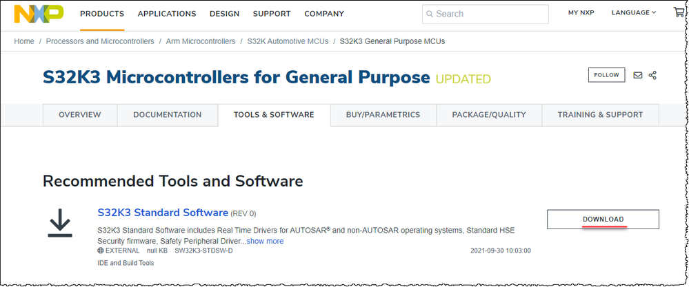

The SW32K3_RTD_4.4_0.8.1_D2011_updatesite  can be download from S32K3 Standard Software.
S32K3 Standard Software.pngS32K3 Standard Software.pngAutomotive SW - S32K3 Standard Software.pngAutomotive SW - S32K3 Standard Software.pngAutomotive SW - S32K3 - Real-Time Drivers for Cortex-M.pngAutomotive SW - S32K3 - Real-Time Drivers for Cortex-M.png
