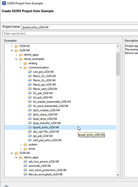

Hi @ErikCarlsson,
The MCU would have to run an application that uses UART.
You can load, for example, this lpuart_echo_s32k144 example from S32 Design Studio

danielmartynek
Hi Erik,
Yes, S32DS fro ARM v2.2 has SDK integrated.
https://www.nxp.com/design/software/development-software/s32-design-studio-ide/s32-design-studio-for...
Create a new project from example:
File / New / S32DS Project from Example

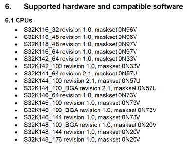

danielmartynek
This is not the production version of the MCU but a prototype.
The SDK v3.x.x in S32DS v2.2 does not support it anymore.
S32SDK_for_S32K1xx_RTM_3.0.0_ReleaseNotes.pdf
I think the SDK may work, but it is not guaranteed.
I would recommend using the 0N57U version of the MCU.

ErikCarlsson
Hello Daniel,
So what I have here is an outdated card, maybe locked with a false program.
What is the best way to get a fresh start with a development board from NXP. I need CAN, regular I/O, counters, and so on.
I can see that the S32K144 Development board is not available at Mouser, Farnell, or ELFA. I can see that they exist at DigiKey.
If I buy a S32K144 Development board again, how can I be sure not to get a 0N47T again?

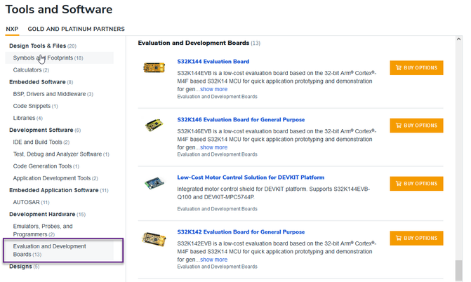

Anything else I should watch out for?

danielmartynek
Hello Erik,
Have a look at the S32K1xx reference manual (2.5 Feature comparison) and choose an S32K1xx variant based on your requirement.
All our S32K1xx EVBs are listed at the address below and you can navigate to distributors from there.
https://www.nxp.com/products/processors-and-microcontrollers/arm-microcontrollers/s32k-automotive-mc...
Only the S32K144 had two prototype versions a few years ago.
And these prototypes are not available anymore, you will get the 0N57U one.
