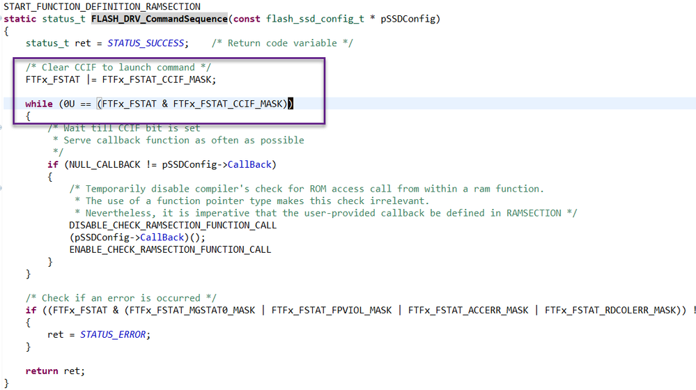

danielmartynek
Hello [email protected],
The FLASH_DRV_Program() function calls the FLASH_DRV_CommandSequence() function that clears the CCIF flag and polls the flag in a loop.
If you program more than one phrase using the FLASH_DRV_Program() function, at the time the function is complete, the CCIF flag has been cleared and set a few times already.
There is no point in enabling the CCIF interrupt after that function.
You would need to modify the driver as I explained above.
