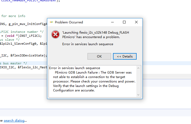

HI,
My S32K148EVB board can't download the program through OpenSDA. Maybe it's because my chip was locked because I chose to jump the cap with hot-plug power. Is there any way to solve this problem?I plugged in the power supply and the USB connection between the computer and the MCU. The firmware I chose was also correct. The picture is an error that occurred after I downloaded the program.false.jpgfalse1.jpg

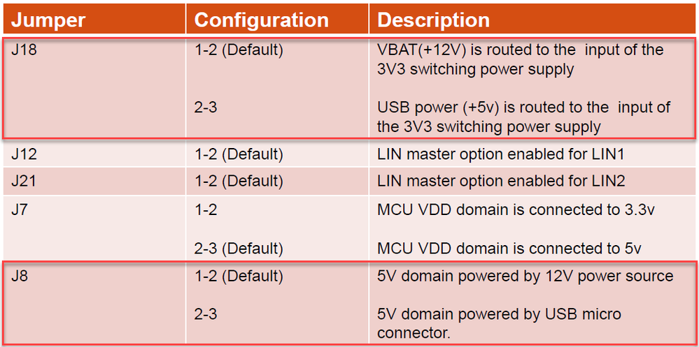

victorjimenez
Hello jianyang wang,
I have seen this problem before, to fix it you need to configure two jumpers to enable the power from USB instead of the external 12V. Refer to the following image.
The configuration for both jumpers J18 and J8 must be 2-3 if you want to program your board through the OpenSDA interface.
TIC

4,628 Views
victorjimenez
Hello Wang,
How are you supplying the power to your board once you make the changes I mentioned before? Once you make these changes, you need to supply your board only through the USB cable.
Victor

840764397
Hello Victor,
Thank you for your reply. I have solved this problem. Thanks for your help. I only use USB as you say. At the same time, I chose Emergency Kinetis Device Recovery by Full Chips Erase in the DEBUGGER option.
