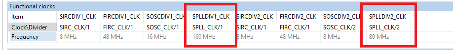

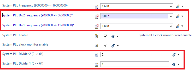

In Processor Expert it is allowing SPLL DIV2 clock frequency as 80Mhz as shown in snap.
Processor Expert ConfigurationProcessor Expert Configuration

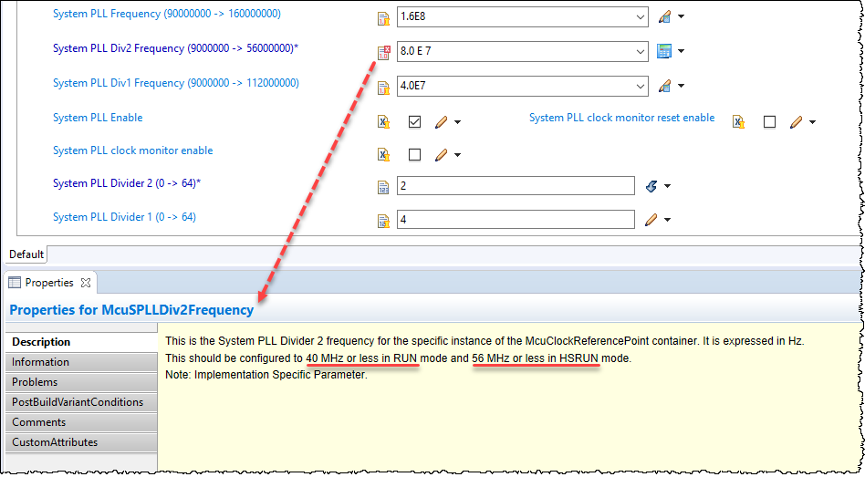

But EB Tresos is giving out of range error
EB Tresos ConfigurationEB Tresos Configuration
Can anyone please clarify this; as we want to use this frequency range for our use.

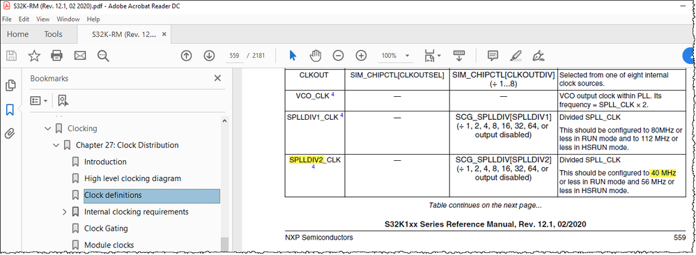

The SPLLDIV2_CLK should be configured to 40 MHz or less in RUN mode and 56 MHz or less in HSRUN mode.
EB Tresos is correct.
S32 Design Studio for ARM Version 2.2 with Processor Expert was error.
The latest S32 Design Studio for S32 Platform 3.3 with S32_SDK_S32K1xx_RTM_4.0.0 has corrected this error.
