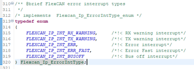

1. Current RTD version does not support BOFFDONEINTFlexCAN_BusOff_IRQHandler only checks for BOFFINT:

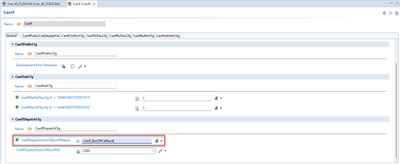

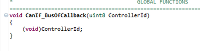

Create 1 callback function for Bus off in main.c. User defines this function by themselves.

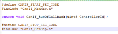

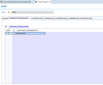

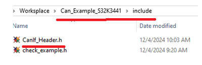

Create 1 header file to extern this callback function and this file will be included in Can_Cfg.c:
In this file, extern the function Bus Off Callback.
Then, in CanIf configuration, fill header file and callback function name.
