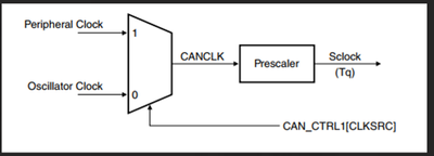

liufei
Hi cuongnguyenphu,
Thanks for  reply,I have resolved this problem,
but I have some question about Can config setting,like this,
Can Controller Prescaller of description:
Prescaler = FreqCanClk / FreqTq; FreqTq = 1 / CanControllerTimeQuanta .
What dose CanControllerTimeQuanta mean?
FreqTq is equal 1/Tq? right?
CanControllerTimeQuanta is same to Tq?
Could you please answer it,thank you very much.
Liufei

cuongnguyenphu
Hi @liufei
As per Reference manual:
1. What dose CanControllerTimeQuanta mean?> Time-Quantum = one Sclock period. CanControllerTimeQuanta means Sclock in below diagram. You can check more detail in Reference manual
2. FreqTq is equal 1/ Tq ? right? > Yes, It's correct
3. CanControllerTimeQuanta is same to Tq? > Yes, It's correct
Additional information:
