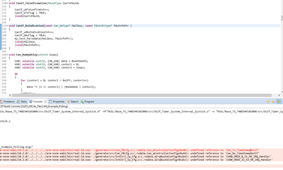

I'm debugging S32K3_MCAL_FlexCAN_Example_Polling,the S32 Design Studio show error:
How can I slove it?

I tried your project, unfortunately I couldn't reproduce your issue (although I saw some other issues, it looks like you have missed some function definitions):
Probably your issue is because of some performance of S32DS. Try to close S32DS, re-open it and then clean the app, rebuild again.

We haven't seen the same issue. Did you try with the original example from the package? Which package are you using?

NXP offline training,modify part of EB.
Beacuse the attachment is too big,so I deleted the MCAL folder.
