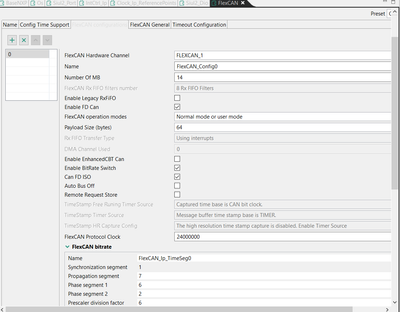

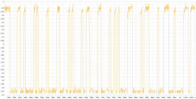

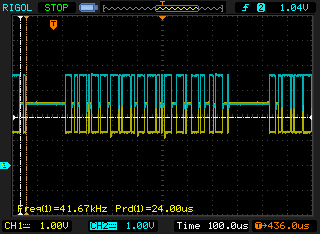

I converted the CAN_EXAMPLE_S32k344 to run in normal mode, but despite the oscilloscope showing a can transmission waveform it is not being picked up by a can485 board from adafruit I am using as a receiver. https://learn.sparkfun.com/tutorials/ast-can485-hookup-guide/all#example-simple-can-network
The blocking send always just times out.
Can someone look at the waveforms I have and tell me what is wrong? I changed the message Id to 200 but I don't think that should break anything. Have I set my segments wrong? I dont know how exactly I am supposed to distribute it just that I am working on 250k bps
canbus high
 canbus low
output from oscilloscope
flexcan settings and baud rate

It appeared to be a clock issue as editing the protocol clock to 16mhz instead of 24mhz (I have a 16mhz oscillator connected so I assume this was the issue), and adjusting the segments fixed it

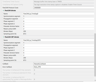

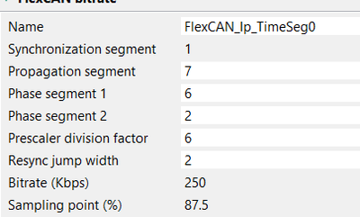

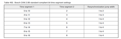

So from reading the User manual is it possible that my time segments are wrong? I only focused on getting the bitrate to 250k. Bitrate and baud rate are synonymous for CANbus?
It appears from this  my time segment 1 would be 15 while my time segment 2 is only 3. Figure 404 is the correct bit time segment figure for Can 2.0B as it says "Classical CAN format (Bosch CAN 2.0B)" meaning classic can and can 2.0b are synonymous correct?

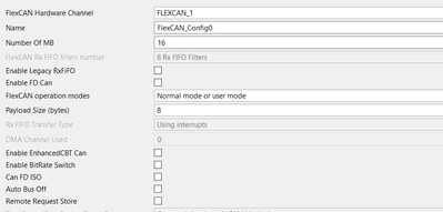

additionally if I only want to be sending "Can protocol specification, version 2.0B" and not
"Can with flexible data rate(can fd)" then I would leave all the boxes here unchecked, unlike my original post correct? I do not know if 2.0b is the default or not but assume the enabling FD can may introduce some errors if I do not know how to use it.

If the issue is indeed the time segments that is the issue, is there any recommendation of time segments or consideration for time segment sizes? Is there a way to look at how the MCAL modules set it up to copy as opposed to manually setting these values myself?
