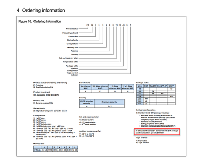

Does S32K342 supports ISELED interface. Please suggest the part number details

Hi @rgr,
Refer to chapter 4 (Ordering Information) from the S32K3xx Data Sheet:
The suffix in your part number indicates if ISELED is supported or not. Please check if your part number includes this suffix.

Hi @Julián_AragónM  - Thanks for the reply.
When I checked the part number with ISELED support, I am not able to find it in NXP website or any distributor website.
  • Is this MCU parts available  for purchase.
  • Also we are not able to find out any details about ISELED in S32K3xx datasheet or Reference manual.
  • Is there any evaluation boards for ISELED available with S32K3xx

Hi @rgr,
ISELED is not part of the S32K families, so the information for the solution is not included in the S32K3 datasheet or reference manual.
You can find documentation and buy options for the solution in the following page: S32K-ISELED LED Lighting Solution.
