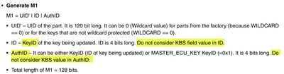

Hi @lwaszniowski
I reported a bug in function calculate_M1_to_M5() short time ago. It looks like the root cause is the same in your case. See please the report and suggestion how to fix it below:
In case of keys from second bank (when KBS = 1, keys KEY_11 - KEY_17), it is not possible to use the same key as authorization key when loading a key. Only MASTER_ECU_KEY can be used.
Reason:
AN5401 says that KBS field should not be considered when calculating M1 and M4 values:
However, the function calculate_M1_to_M5() masks KBS only in case of key_id:
If such M1-M5 values are used to load a key to second bank when using the same key as authorization key, ERC_KEY_INVALID is returned.
The solution is to add also this code here:
auth_key_id = auth_key_id & 0x0F;
Then everything works as expected.

lukaszadrapa
Hi @lwaszniowski
Reason:
Lukas
